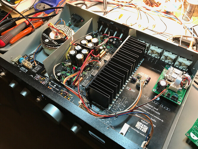

I thought I’d give the Open Loop Acquisition a go on a Cambridge Audio A5 amplifier where I’d added an Arylic Wifi Audio Receiver Up2stream Mini V3. The wifi and BT module is mounted on a daughter board located where a phono stage is usually fitted and provides the necessary 5v at 1A power and audio connectivity:
