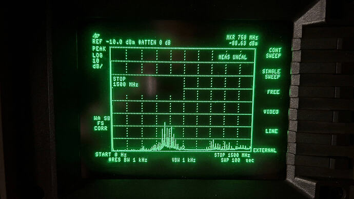

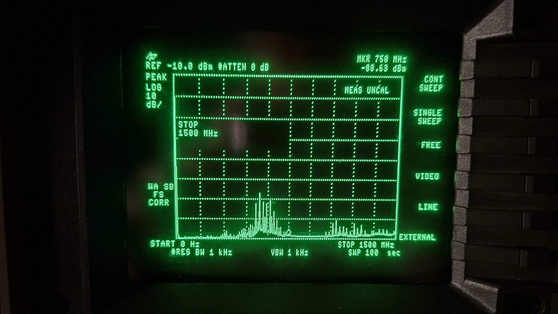

Hi, after buy of an old hp spectrum analyzer 8590A for my RF hobby I could now show the residual of my QA403 left and right output unbalanced connection. Since the RF input is 50 Ohm the signal is attenuated. The residual signal is between 500 and 600 MHz. Used GEN1 but in STOP position. The capability of the analyzer does not show signals with smaller level as I can measure it with my analog level meters. Update with a higher resolution spectrum scan since I learned little more to use this analyzer. Last pic here.
