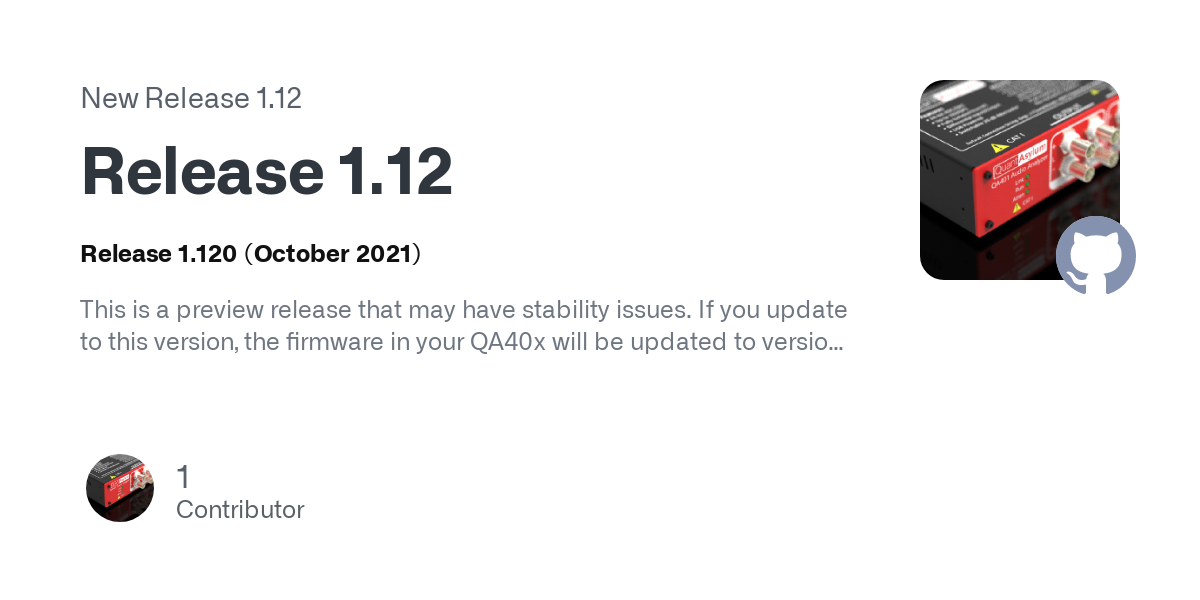

Good find, thanks very much! The gain for the right channel depended on the left channel peak, so if the left channel peak goes away, the gain is wrong. For 1.12 that will be changed, along with 192K swap.
Hi @Rammis, I just verified it appears fixed in 1.12:
