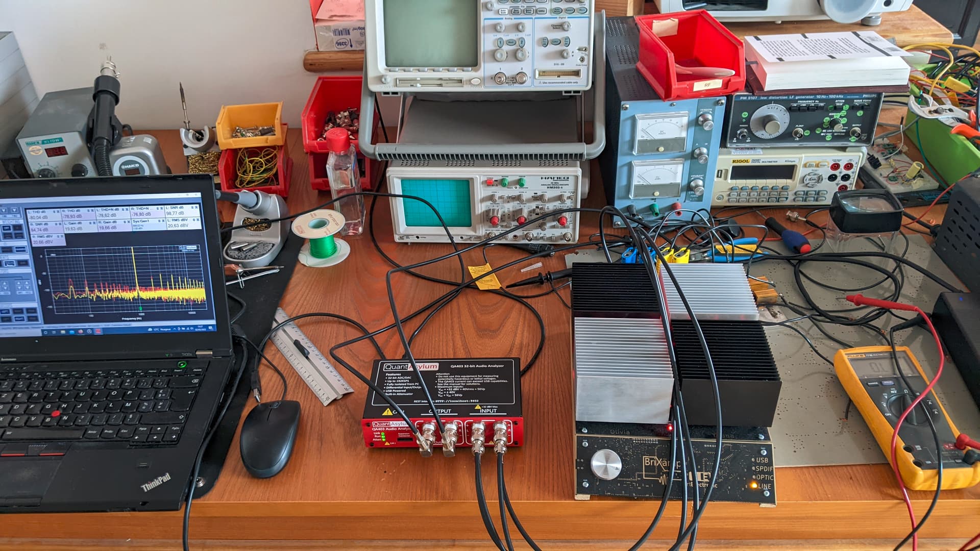

Just received a QA403!
What a wonderfull device!
First measures soud good for my hifi amp project!!
THD behaviour just as expected, off course a little bit high especially from right chan but the concept of my amp works.
Here the first measure run, amp attached to 4R resistive load, both chan:

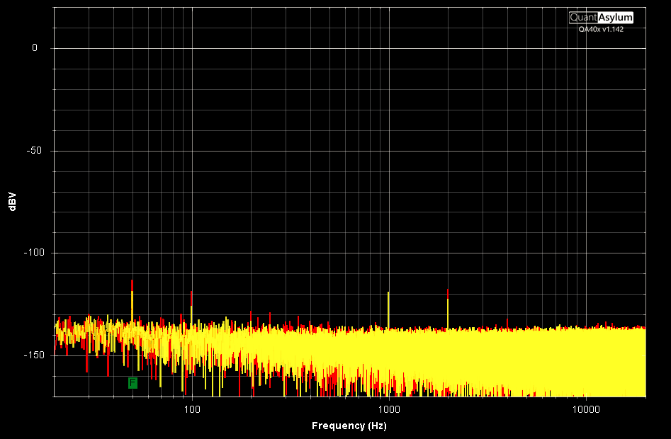

Noise look good:
Expected with the tests I did with headset. The config for noise measure is to leave QA403 generator ON and lower the volume from my digital volume inside the amp (a PGA4311).
Now can go to fine analog work yes!! Thanks QuantAsylum for your wonderfull device!
Nice set up- thanks for sharing!
