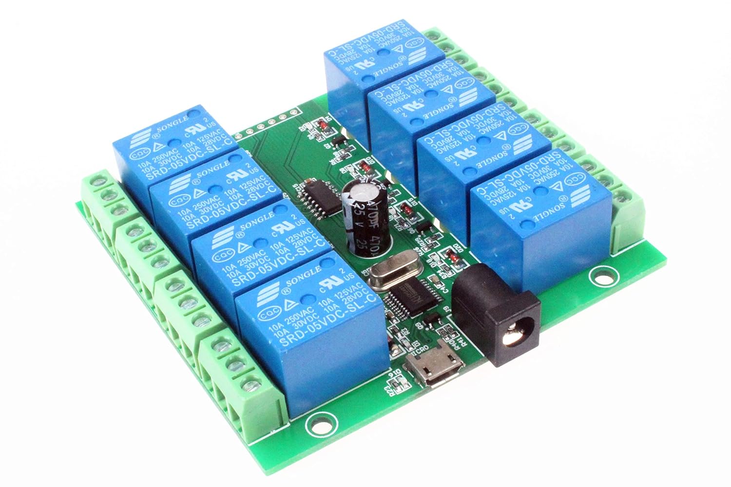

You could use something like this but crosstalk may not be great:
They are easy to use, just send commands to a virtual COM port.
