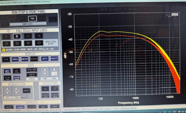

Hi Matt,
I get some weird results with your software measuring an EBS Classic 450.
If I use the chirp preset of the QA40x-Software, I get this:
Settings: Smoothing 2, generator output level 0,1V, 20 - 20.000 Hz, 48kHz, FFT 32
Yellow: Speaker output at 4 Ohm
Red: Line Out signal, both after the flat EQ.

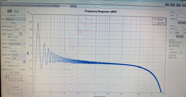

Using your software (response), I get this:
Whats that? Lack of smoothing?

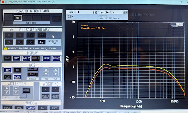

The graphs shown in the QA40x-software of exactly this measurement look like this:
Any hints?
