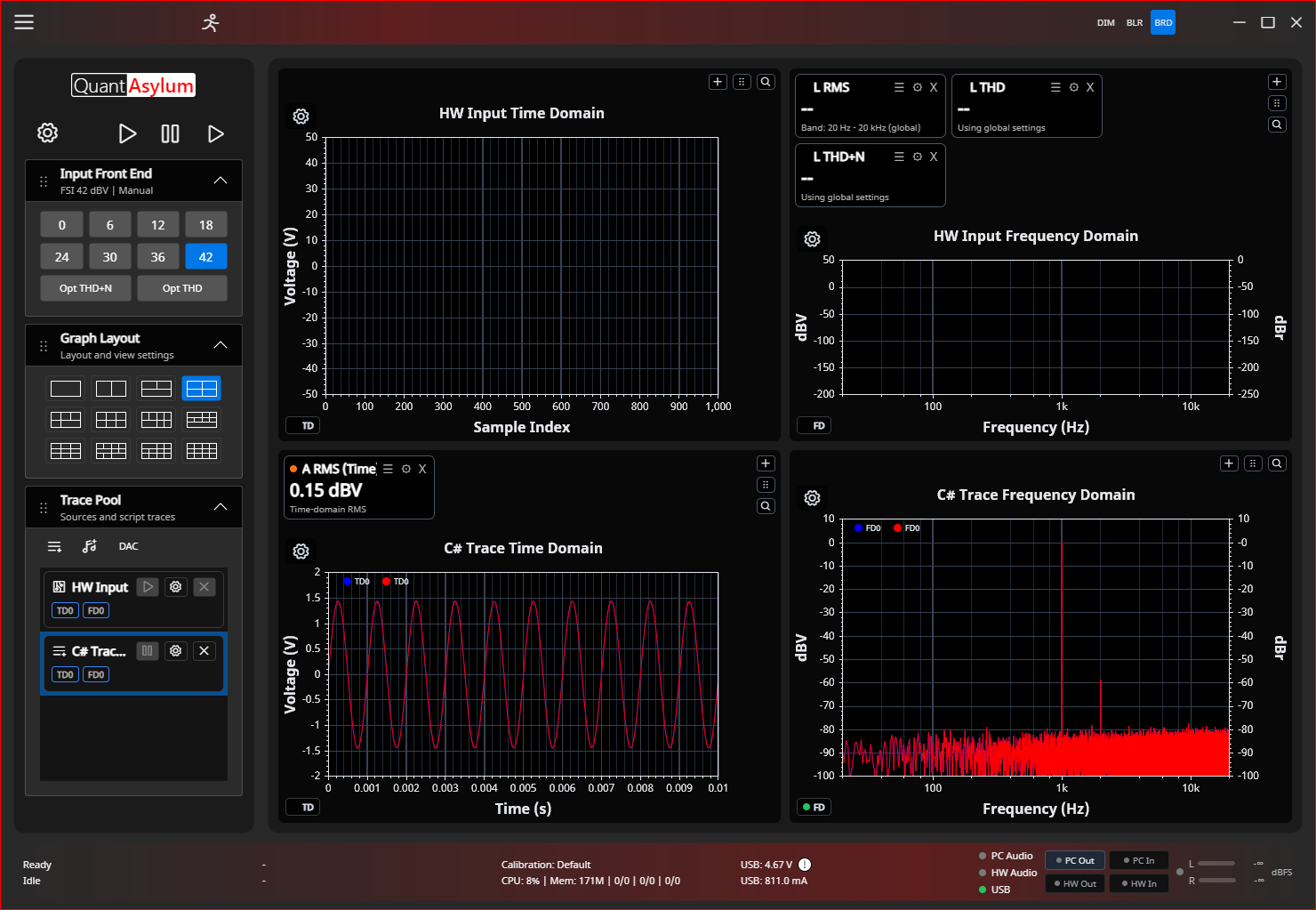

The app should come up looking as below:
TASK:
Confirm app will show the selected language. The language may be spotty as localization is mechanical and not all the way up to date. The key is if you see SOME strings rendering.
Trace Activity
In the two lower windows, you’ll should see activity. The lower two windows are connected to a C# trace generator that runs and updates every 250 mS or so. This can be turned off by locating the C# Trace Generator tile, and clicking the gear.
That will open the generator properties:
Uncheck the Loop Generation and hit Apply. The updates should stop. Close the app and restart it.

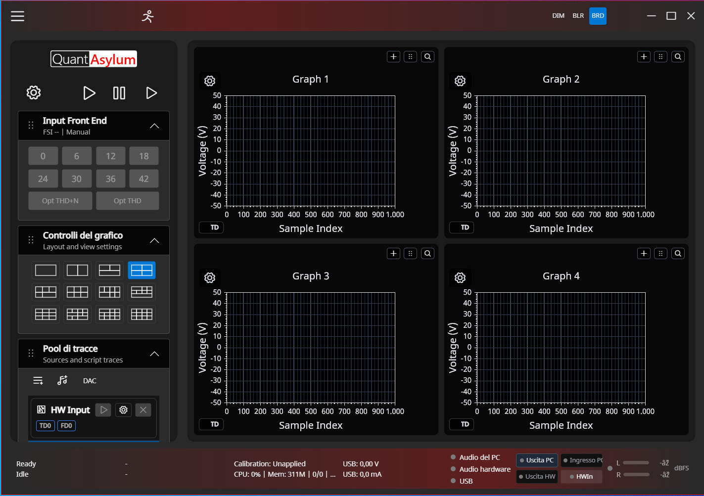

Windows 11 pro 64bit, even forcing en language, I get a mix of italian/english:
Hi @Clane, yes, that is expected right now. When 1.0 is released, all the strings will be properly converted. For now, the strings added since the last conversion are still in english. If you see even one string in Italian, that means it correctly detecting and picking the right resource.

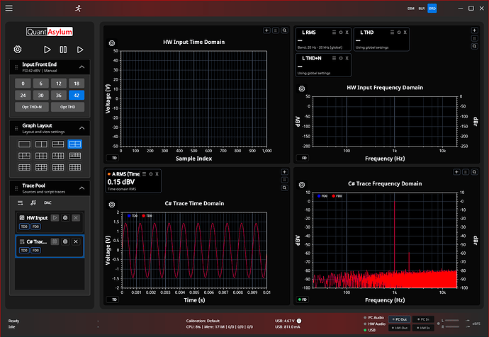

Hi. On the logarithmic scale, I find this division into decades a bit odd: there aren’t the usual 10 divisions. Is it possible to adjust this setting? Am I missing something? Thank you
