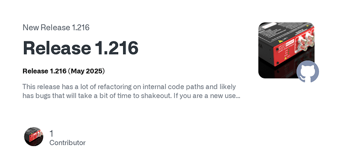

Release 1.216 is up on Github
Release 1.216 is up. There’s not a lot of new features, but instead a lot of internal cleanup so be aware a lot has changed internally. Change list is at the link below.

HAs anyone used this version and if so, have you found any bugs?
I’d like to install it but I’m not very comfortable with knowing that there’re might be quite a few bugs, according to Matt. :slight_smile:
