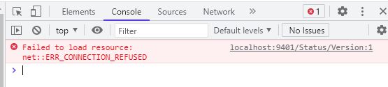

Can you open developer tools in Chrome and check for error messages in the Console tab? Press F12 to open, and you might need to reload the page to see any errors there. A screenshot and a description of what you did to get the error is very helpful.
I am using the latest version, I think it is .992. Here is the error in Chrome (I think):
Capture1
Does not mean much to me… thanks for helping…
Ah, looks like you started QA401 Web. QA40x Web should connect to port 9402 instead of 9401.
I guess you downloaded v1.3.0 from releases on github?
I have not created any release for QA402 yet, so you need to get the development version on the main branch. You can get it by clicking the green button that says “Code” on github, and “Download ZIP”.

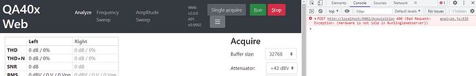

Thanks- downloaded as you suggested and tried running and still no luck- got this error:
I’m able to reproduce that error if the QA402 software is already doing acquisitions. Make sure it’s not doing anything, and the messages in the status bar looks like this:
Screenshot_20210904_111912
Does that fix it?
Thanks. I think the QA402 software is running. Am getting ready to leave town for a few days so may not be able to try until I get back- that will suck. Will let you know…OK. I could not wait that long so hooked it up to another computer that I have not used the qa402 on and it worked!!! Now I have to wait till I get back to measure something- a carver c1 preamp most likely. I know where to go if I have questions!

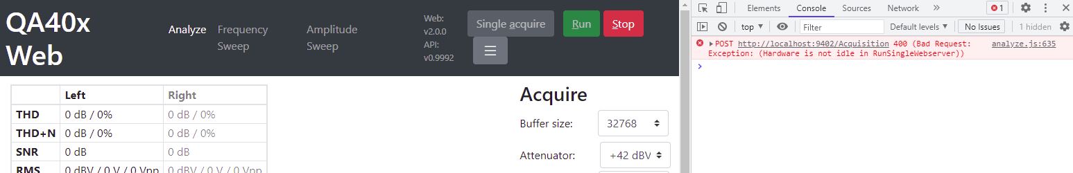

I think I was able to reproduce the issue without having the QA402 software doing acquisitions.
I was just changing some settings with the web interface, and then I started getting a mix of Hardware is not idle in RunSingleWebserver and The QA402 hardware is not connected when trying to acquire from the web interface.
The status bar looked like this at that point, while being idle:
Screenshot_20210904_190352
The QA402 software did not respond at this point, so I had to kill it. After starting it again the status bar looked like this:
Screenshot_20210904_190736
The QA402 software responded to buttons, but nothing would show on screen.
I quit, unplugged the power to the QA402, and restarted the QA402 software, and it started working again.
@matt maybe there are some race conditions in the api from the web interface sending lots of post requests? I remember we had some of those in QA401H.
Thank you :slight_smile:
Yeah, I guess you ended up in the same inconsistent state that I did just now, and it’s easily fixable.
